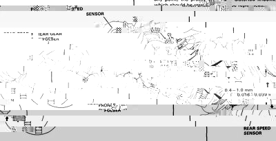

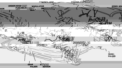

** I've included shop manual images (below) of the front and rear sensor locations, as well as an actual sensor set, showing the full cabling, wiring, etc. Just so you can go into this semi-prepared, if you chose to.
CLICK ON IMAGE TO ENLARGE
